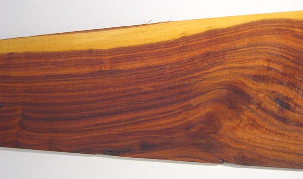

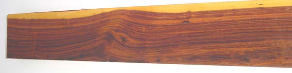

I have set myself up to cut my own fretboards. Here in Western Australia things are quite arid once you move inland from the coastal crust.
Due to the lack of available water and nutrients, the trees (read as scrub) grow very slowly. This slow growth dictates that most of the desert timbers are VERY hard and of course dimensionally quite small. Not a good thing for back and side sets, but when it comes to things like fretboards and bridges or even pins and turner keys, we certainly have the goods here in WA.
The hardness or density of these desert timbers is generally up there, or in excess of cocobolo or ebony. Some of this stuff weighs in at around 1300kg per m3. So, just a warning for any nautically minded amputee luthiers among us, you really do not want to build a wooden leg from this stuff.
Not only is it be too heavy to lug around all day, but it is note worthy that this stuff does not float, not at all, not even just a little bit when it is totally bone dry. If you fell overboard, or if your stopper came off your leg causing it to poke a hole in your boat, you would sink like a stone
Anyhow, last night I resawed a small log of Mulga ( Acacia Aneura) attached is a couple of images of one of the fretboards I converted out of the smallish round that I had. This piece has been shellacked to show figure. Not only is it just as dense as Coco, it even looks like Coco, what do you reckon, do you like the sap?
Probably not the same intensity of ink lines as Cocobolo, at least not in this bit, but it still looks pretty and it rings like a piece of plate glass. Also, because moisture is low, even when green, this stuff is very stable as a rule.
Cheers all, hope you enjoy
